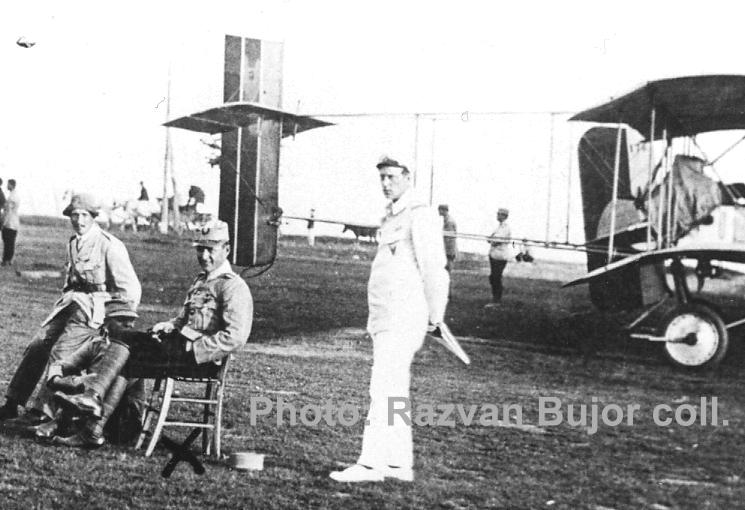

On a single photo I found the identical style of painting the vertical stripes on the rudder as shown in the in-air Nieuport photo posted by Cantacuzino. However, this photo depicts a Voisin, which was used only in the early stages of the war in Rumania, certainly not in 1919.
Note the standard rudder colouring of the Farman, seen at right.

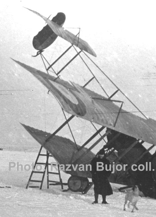

On a single photo of a crashed Rumanian Farman I found the standard blue-yellow-red rudder colouring, but what appears (still) French style wing cockades, with the centre circle being probably white.
A rarity, indeed.
