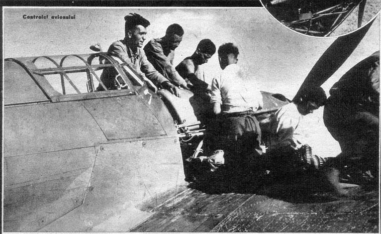

1) Hawker Hurricanes 1 to 12 had metal wings. A very good indicator to identify fabric versus metal wings is to look in photos for the position of the landing light in the leading edges of the wings. On fabric wings, the landing light is very close to the gun ports. On metal wings, the landing light is further outboard. The distance between the outermost gun port and the light is roughly the same as the distance between the first and fourth gun port. Most photos of Romanian Hurricanes show the leading edges quite well and it is very evident that the light is far outboard.

As Cantacuzino said above, there is overwhelming evidence that proves without any shadow of a doubt that the 12 Hurricanes purchased from the UK had metal wings. There are photographs that clearly show the position of the landing light, rivets, chipped paint revealing the metal underneath and the distinctive shape of the gun bay covers. You do not have to take our word for it, please have a look for yourself here:
All photos are from the link posted above.
