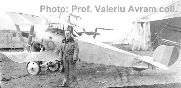

Posted: March 08, 2005 11:46 am
Below it's a picture with romanian Ni-17. Unfortunetly i don't know the year of the picture and the name of the pilot. The color is silver. The yellow from national marks of rudder is more darkness compare with blue.

Posted: March 08, 2005 12:13 pm
In that Modelism "issue" biggrin.gif was one painted in dark green, or something like. And one in white - steel i don't know how to say that colour. And both planes remembered had personal signs. More, tomorrow, after i look at some "issue"'s . biggrin.gif
Posted: March 08, 2005 12:25 pm
It's silver. ( aluminium powder paint )
