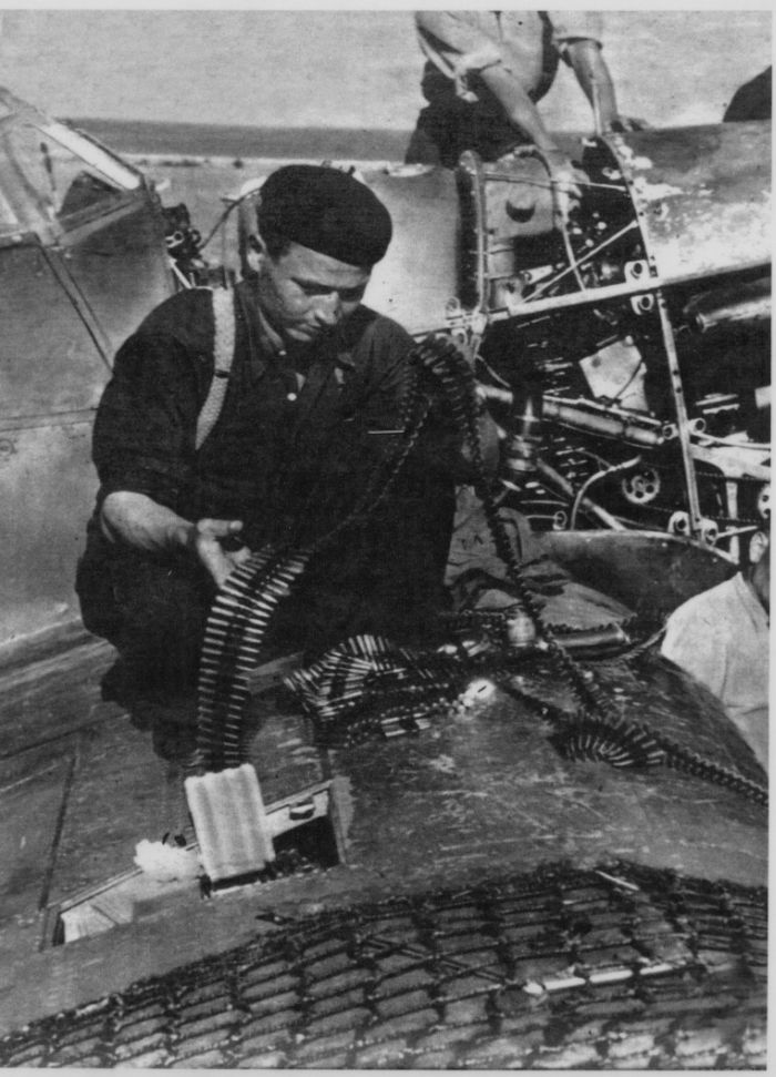

Below another picture of a romanian Hurricane with metal cover wings. From" Aripi Romanesti" WWII aviation magazine.
( I am still waiting picture with fabric wings from knowledgeable people)

I saw yesterday in a private collection a romanian Hurricane with fabric wings smile.gif (Yugoslav ???). So at least one was with fabric cover. I don't have personal that picture so i can not post it .
BTW. i also saw in the same collection the romanian Hurricane nr."Yellow 2", Yellow3", "Yellow 4" ,"yellow 5" and " Yellow 7" with metal cover wings.

QUOTE (Cantacuzino @ Feb 22 2005, 01:25 PM)
What number was it? Could you see the ARR markings?
P.S. Are those photos in D.A.'s collection?
I can not see the number nor the ARR markings. But the mecanics changing the ammo were romanians.
Yes, D.A.
This post has been edited by Cantacuzino on February 22, 2005 02:12 pm
