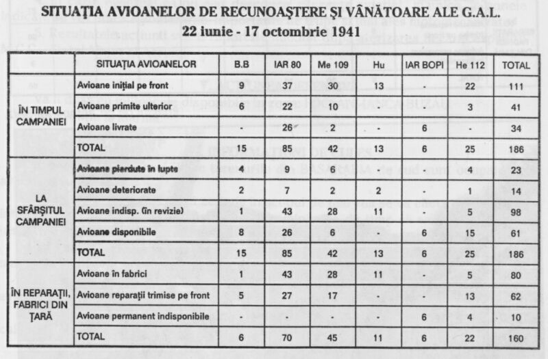

Hi Aleks, thanks for understanding. I have some news for you regarding Yugo Hurry in ARR service. I found a rom. document with the status of romanian planes used (in Barbarosa operation) for eliberating Basarabia. And surprise the number of Hurricanes used on front line was 13.
In 1940 we received from British 12 planes but in the same year we lost one plane with Cpt.Draganescu ( test pilot) who crashed after a low pass roll. That means in 1941 ARR had only 11 Hurricanes left from the first batch. The 2 Hurricanes added at the begin of Barbarosa were 100 % yugo planes. That means ex.Yugo Hurricanes fought against soviet army. That explain picture with Hurry in ARR with fabric wings. In my opinion the initial number of Draganescu lost plane was given to one of 2 Yugo plane in 1941. The picture with Hurry number 12 with axis markings help me for this conclusion.
This post has been edited by Cantacuzino on February 25, 2005 10:15 am

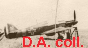

In my opinion the initial number of Draganescu lost plane was given to one of 2 Yugo plane in 1941. The picture with Hurry number 12 on fin help me for this conclusion.
If someone know what was the number on Draganescu Hurricane we can assume that the same number was given to replaced Hurricane from Yugo batch.
Below picture with Romanian Hurricane nr. 12 with axis markings in 1941.

QUOTE (Cantacuzino @ Feb 25 2005, 02:26 PM)
The 3 ex-Yugoslav Hurricanes were delivered to Rumania just before the start of the war on East (I already wrote this to Aleks). They received the tail numbers 13 to 15.
In ARR, no old serial number was re-issued to a new airplane.
BTW, the document you posted - copied from a book - is not accurate regarding the Hurricanes (I didn't cross check the other airplane types).
The 2 Hurricanes given as "Damaged" were, in fact, written offs. One was shot down in air combat, while the other one, an ex-Yugo Hurricane, was destroyed on ground by strafing Soviet fighters.
Based on the info given by Aleks, what camouflage colours were on the rag-wing Hurricane you mentioned?
I am sorry was not a color picture. The picture it's not in my personal collection and i can not check such details. The only thing sure was fabric wings( judging by hatch guns in the wings as in drawings) and romanian mecanics changing ammo.
The three tones of Yugo cammo it's hard to recognise from B&W pictures if they are not so clear. Probably only the number on the fin could help for the issue with rom.ex yugo Hurry.
If you allready had such usefull information for Aleks why you waiting so long to let him know sad.gif
Mayby my posted document was not a perfect one ( indeed is a copy of a document made after the first campain but it's not a fake ). At least i try to help Aleks with what i could and i warned him that one general D. will sent me to Martial Court if i fail. So who knows a good lawyer for me ? smile.gif
