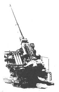

Posted: December 31, 2004 09:57 am
"'Longhand,' the last of the 3.7s. With automatic ammunition feed, it could reach a rate of fire of 60 rpm. However, within weeks of its being approved the guided missile, made it obsolete. "
This is the mechanism? But 60 rpm at 94 m.m. caliber is ... verri fast!

Ruy Aballe
Posted: December 31, 2004 10:48 am
Posts: 307
Member No.: 247
Joined: March 18, 2004
I forgot an important detail in my last post: I should have written "from the Mk.III on", because the auto loader system was fitted from that version onwards. Some Portugeuse guns - a few mobile Mk.IIIA and quite several mounted on a fixed plinth - had it, so I can ask a friend to scan the original manual, if available, and to made some photos of the gun itself.
I can post photos made by him of what I suppose is the QF 3.7inch MK.I, as preserved in a Military museum - I would love to locate one of the guns modified for the AT tests, though... By the way, the mobile guns of the Portuguese army ended up by being used for direct ground fire work in Angola and Guinea in the 60's, using a special HE round.
As for your last post, the answer is no, this is not the auto loader fitted to earlier versions of the gun. The "Longhand" is a post-war development and the last of the heavy AA guns developed in the U.K. Yes, the firing rate is truly amazing for a gun of its size, but it represented an evolutionary step from similar systems used in smaller guns. It should be noted that the British had an enfatuation, since long, for semi-auto loading systems fitted to AA guns. The Vickers Armstrong company began experimentation in this field as early as the mid-Twenties.
