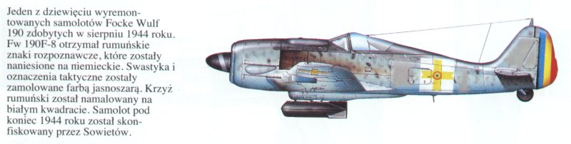

I heard the Germans were going to equip the Romanian armed forces with Panther Panzer's V tanks and with Focke Wulf
190F-8 Fighter bombers (such as this one), in late 1944.
This however never happened since Romania switched sides, and so therefore part of this equipment went to Hungary instead.
I wonder how the Fw's would have performed, a big ' + ' for them being that they were such a good aircraft, but a small ' - ' because the Romanians did not have experience with Focke Wulfs,..(Hungarians did), and only with 109's.
