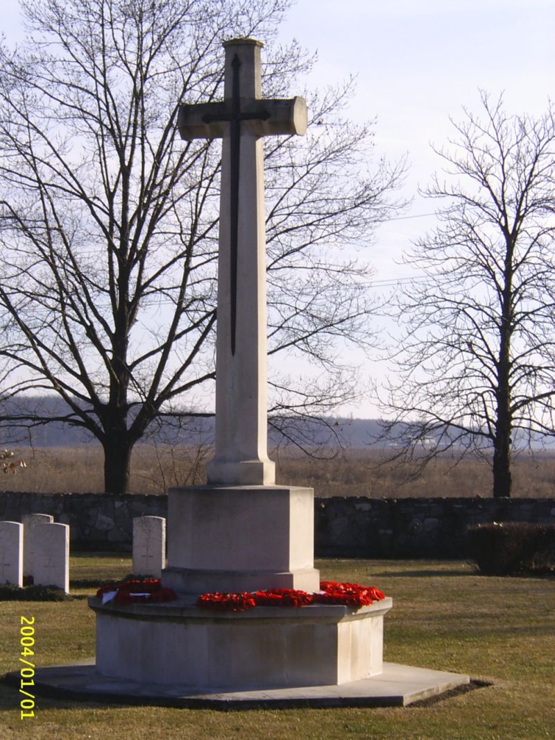

MacDonald was the British Air Attache in Bucharest during the 1980's and became interested in why there were so many RAF graves in the graveyard at Tincabesti
The monument dedicated to all RAF ( and Commonwealth) lost airman in WWII over Romania from Tancabesti cemetery. Courtesy Dan Melinte.

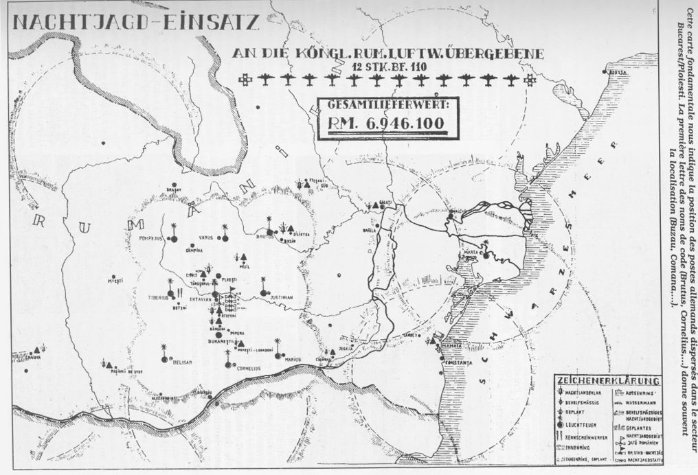

Posted: February 28, 2005 10:44 am
German radars position map.
Cornelius was the code name of the one placed near Comana village.( book Chassse de la nuit..)
Posted: February 28, 2005 11:51 am
Dan
This chart if translated from French to English says it shows all location of the German visual night signalling aids and status for night fighter activity and not German Radar locations....from German translated it also indicates the 12 BF-110 soled to ARR for the amount mentioned ....the circles are NAV compass roses and the legend indicates the night signalling status of each facility........it doesnt indicate about any Radar station location.
Also I am not aware nor there are any RAF reports that Halifaxes and Lancs were lost over Rumania....it could well be an RAF B-24...however if you have clear evidences from the crash site pointing out of a Halifax , let me know
This post has been edited by alexkdl on February 28, 2005 11:53 am
Posted: February 28, 2005 01:22 pm
Dan
Yes Alex you are right they are not radars but radio control centers who direct the german night fighters to the night intruders position ( or something like that). But also Wurzburg radars could be part from that complex sistems ( visual, audio, signalling, radio). I will check for more in that book.
