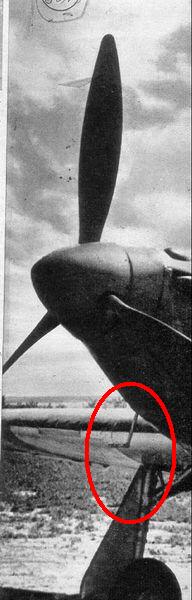

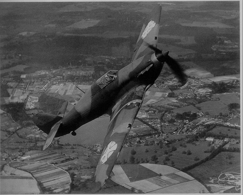

At least some of the Yugo hurricanes wore the B type raf camo, as this fabric wing Hurricane shows.
This photo clearly shows the old RAF markings overpainted on the tail, fuselage and wings.
They could i guess be identified among the ARR ones by the shape of the unarmored wind shield.
Picture from Monografie Lotnicze 52, Hawker Hurricane cz.2
This post has been edited by 109 on February 28, 2005 09:59 pm

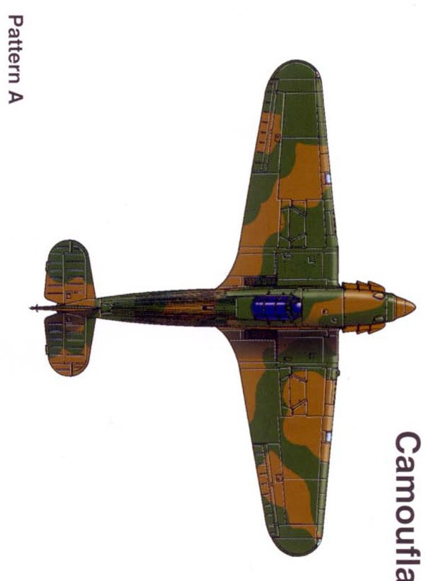

The standard B camo (source : Hurricane Walk-Around by Squadron)

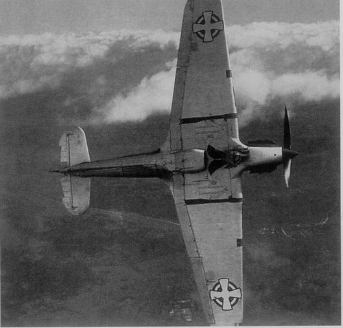

Here is the underside of the same Hurri as the first pic;

Thanks for the pictures . They are greats. Also the undersurface of rom. service Hurry pictures could lead us to find ex. Yugo Hurry. But unfortunetly all the pictures with rom.Hurry that i saw were black and white british cammo undersurface wings.

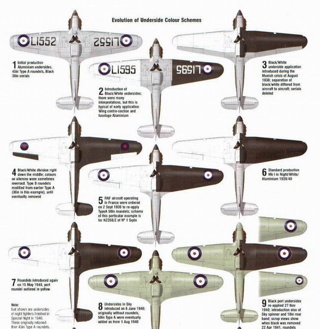

The problem is, which of the RAf caom types ARR planes had?
Here is a fragment from the excellent SAM book on hurricane.
Based on the delivery date, there could only be between 2 and 6. None of them feature any sky colour on the undersurface, just black, white and aluminium.
The sky undersides apeared in may 1940, after the batch of 12 Hurries were delivered to Romania.

Based on this photo from Aripi Romanesti wartime magazine , the undersides could have been the second type of raf camo. Other photos in which the left side is obviously black contradict this though ...I wish someone would be gentleman enough and share with us a clearer picture...any?..no?

I agree with you 1-0-9( from the modeller point of view). But the brit give us (today) so much trouble with all that different types of undersurface cammo in a short perioad for Hurry.

All RYAF Hurries were overpainted in three tone upper camo before the beggining of war. British serials posted by our new colleague are correct.

I forgot to menion that photos of RYAF machine on the top of the page are property of Mr. Malcom Passingham. They are made in England during test flights.
