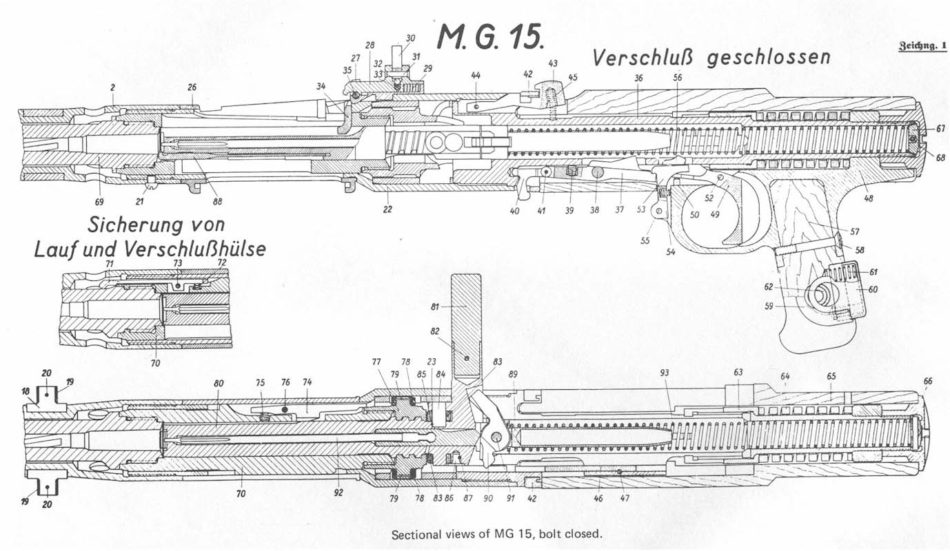

I have added more drawings and information at:
http://brenlmg.com/6/ubb.x?a=frm&s=8446044...83&f=1286072974
The following drawing is from "German Machineguns" by Daniel D. Musgrave & Smith Hempstone Oliver and is reproduced here with the kind permission of Ironside International Publishers, Alexandria, VA.
