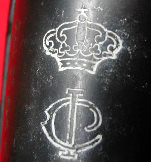

The same caliber was also adopted by the (then) Royal Portuguese Army, exactly for the same type of rifle - a Mannlicher turn bolt design, whose mechanism later inspired the local Vergueiro bolt, used in the Mauser-Vergueiro. The Portuguese Mannlichers were known as M.1896 and Steyr built 8.000. It is perhaps interesting to note that most of the actions were taken from the original Romanian contract... that's why some Portuguese guns have Romanian markings on them, even in the action, namely the Phoenix stamped just on the right side of the bolt enclosure. However, the action ring always bears the cypher of King Carlos I, as also found in the Mauser M.1904 and early Portuguese Lugers (please see photo below - from private collection).

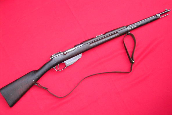

And here's a photo (same private source) of the complete carbine... or rather a "short rifle" for the late XIX/early XX standards: the official designation was "Espingarda Portuguesa Modelo 1896".
